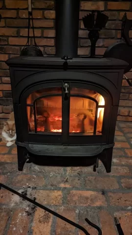

Do you get black glass on the top of the glass? I get it in the same spot on my stove every burn.
[Hearth.com] Vermont Castings Blowtorch Sound on Reload
Oh ok. Lol. That would have been crazy.
i get black glass yes. its in a pattern though. def behind the andirons. i stopped cleaning it, it doesnt matter what i do it gets black. the dryness of the wood is a big factor. my wood is good this year but in years past the only clean glass burns i had were when i added a sawdust tractor supply log to the fire. i would wake up to perfect glass. i think i cleaned my glass so often that i made an air leak between the glass and the door.
Yeah, if you look at the attachment on the last post, it's black from one clip to the other, door to door. Makes a semi circle. I can't figure it out. I do have air getting in from the top lid. I confirmed it with a smoke test. The dealer has been useless though. Won't get back to me.
