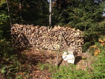

My solution!
  • [Hearth.com] What happened to my stack!
