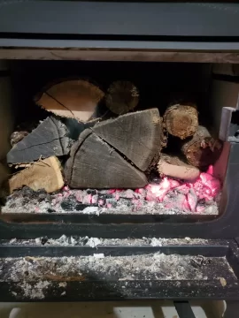

It's 2 maybe 3 inches to floor frim lip. I let cosls burn down some but raked most to one side and hitting bed early. Usually I will load later, but didn't want to wait to burn it down. My wife had a bunch of coals buildup from today and o got impatient because I am tired. How much do you let the coals burn down before reloading? I am guessing it takes awhile to get to cruising from alot less coals? I am all for advice, this it the first one that has run hot right off the bat in cold weather. I noticed that if I pack tighter with a couple big splits I have better control.

I am lucky by the fact that my stove is in the basement. So I can run down the coals (with less heat output from the stove) for a while before my living area up the stairs sees a measurable temperature decrease - because the "heat reservoir" in the basement keeps the upstairs warm for a while. My stove has (closed) tubes with combustion air (going to the window airwash, which is the only air into the stove) that run slightly upward from back to front - and that sucks, because if I rake the coals to the front (for good burning of the load since the air comes in the front), I will bump into the top of stove way sooner in the front than in the back (b/c now both bottom and top are tapering in the front). Therefore I will not reload (barring need - as in "too tired to wait"; I get it) until I can spread out the coals in a thin layer on (or in) my ashes. It ignites well then, so no need to have all coals in front.
But I will take out ashes when they are more than 2" thick - I'll go down to 1/2" then or so. I have a cat-poop-scoop (all metal) from amazon that I use to filter out the coals (hot or cold), put them to one side, and then scoop the ashes from the other side. Then I move the coals to the emptier side and scoop ashes on the opposite side.
I also heat from the basement and love it. As you say that heat reservoir keeps my first floor warm for a long period once stove has started to cool. Then once loaded again the temps upstairs will jump up even on colder days. I can't image having a stove in my living space, at least not in my setup. I will occasionally rake coals flat in a thin layer which is probably what I could have done tonight. Sometime when I load too much overnight I end up with a bunch of coals to burn down in the morning before loading and going to work. I have gotten that timed pretty well so I can load without too much delay in the morning. There wasn't much ash in my firebox as it was mostly coals. I do exactly what you do with a shovel with holes and stack coals in one side and fine ash on the other. I do this every handful of days not allowing it to building more than half inch or so. Then on the lawn it goes, my grass seems to love it. About how long do you get up to temp and cruising when loading full on a thin layer of coals/ash?
My (cat) stove recommends to go full blast 20-30 mins before setting at the lower output I want. By then it heats so much that it's hotter than I want.
I'd say I get reasonable output in 5-10 mins after reloading. Not max or cruising level output, but fair. But I suspect this is quite stove (and draft-chimney) specific.
Ah, I have been thinking maybe I should have gotten a cat stove, actually looked at the Ideal Steel, which my father has. I shyed away from it do to my oversize masonry chimney. Thinking I should have done it, I still wonder. Oh well, this stove isn't bad, but would like to set it and forget it sometimes.
I don't know your stove, but one can often dial in a non-cat and walk away once it cruises? That is set it and forget it? I guess we all do that over night.
Anyway, the grass is always greener on the other side of the fence. Just enjoy the heat.

You can close the air down real quick when loading up on some hot coals with our Lopi Liberty, I've loaded up with a stove top temp of 300.
You should be able to control how hot your stove burns by how many splits you put in along with how much air you give it.
