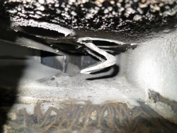

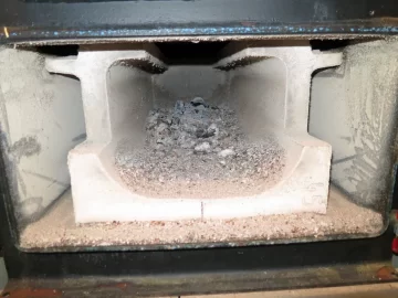

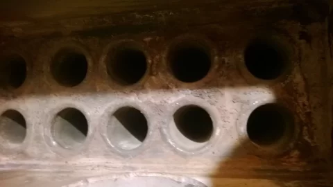

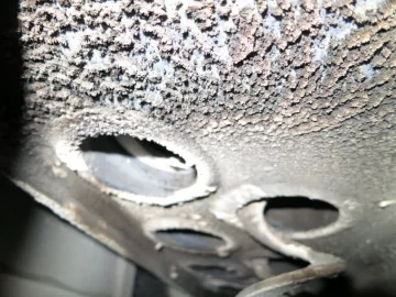

Did my weekly cleaning of the lower chaimber and opened up the lower cleanout to see the bottom of the tubes. This is the second time this season to vacuum out back here.
This is what I found, I think everything looks good, what say the boiler room?
BTW, these are all cleaned out now :)

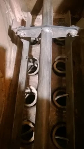

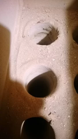

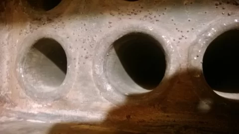

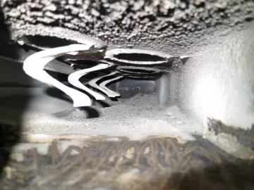

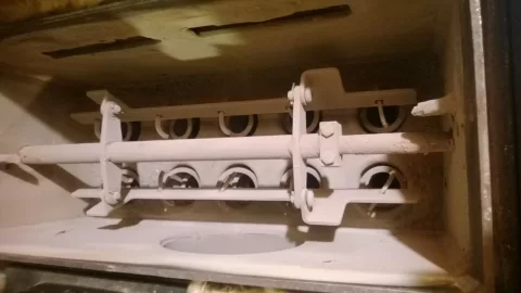

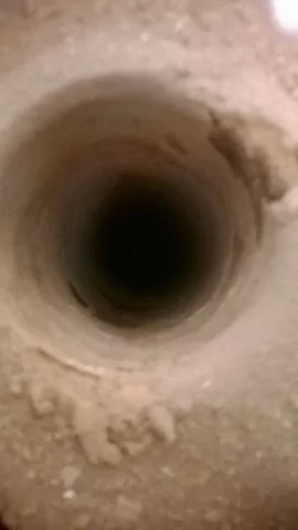

TS
Just cleaned the HX and turbs.
I attached 3 before and 3 after pix.
Whole process took under 40. minutes and last time it was cleaned was over the summer shutdown.
Thus far this winter the ash accumulation seen was from 4 to 4.5 cords of wood.
The turbs, were also coated with same soft ash and just run a brush out and in.
No gummed up stuff, just very soft powdery fly ash.
Last night's burn(before cleaning) registered FG high 232C,
Today's burn FG high 182C
Scott
