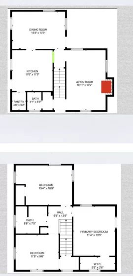

The photo I’m including is my 1871 house. First floor on top and second floor bottom. Red square is my encore. Green mark is where I plan to cut a new door opening to the kitchen as currently you must walk though the dining room to get to the kitchen and the proposed door would improve air movement. The current door will be changed to a rectangular serving window connecting the kitchen and dining room or I’ll wall it off completely.
A member recommended installing a vent fan drawing air from kitchen to living room(heat source)

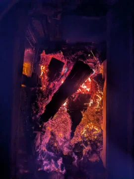

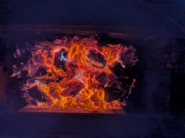

Here's my stove this morning after 10.5 hours of burn time last night. I loaded the stove last night a little before 7pm it wasn't loaded full but enough to get me to morning. The first picture is just opening up the stove and the 2nd is with a little rake and some air in it
Can't complain about a nice coal bed like that.
