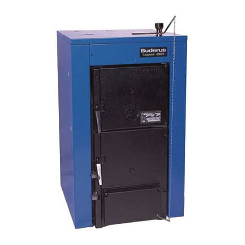

We heated our parents' home with a Buderus wood boiler for years, but that probably doesn't count. It was similar to this one:
