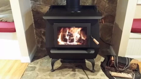

Yesterday first full load ever in my new King. 24.5 hours later I woke up to find nothing in the firebox. Not one leftover coal and barely any ash. Stove was still warm to the touch, house was still 70 degrees downstairs AND upstairs. All on one load of cherry. Amazing.
I can't even really give a good estimate at this point on how much wood I will save this year compared to last year. [Hearth.com] 2015-2016 Blaze King Performance thread (Everything BK)
