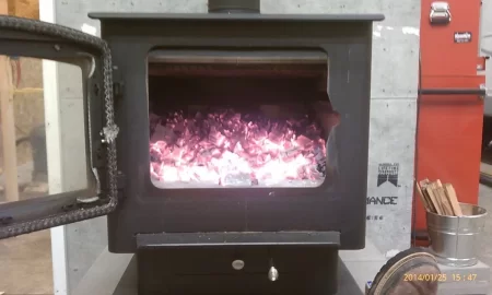

Well by coal / coals building up what I mean is it happens when you open the draft way up to introduce more air for a hotter fire. Eventually you are burning and reloading so often that you need to stop adding wood,... and let the coal build up burn off because you end up with 8" deep of coals.
Last year was pretty brutal for my area, lows zero to 10 below zero and highs in the single digits to low teens, my stove is in a un-insulated block wall basement, I definitely asked a lot from my princess, I had coal build up issues from running it high, what I would do is take smaller splits in the am when I first wake up and load them in, turn the t-stat all the way up and let her go full throttle while I got ready for work, I would be able to burn the coals down considerably within 40min, and I would have enough room to do a full load and go.
I must be missing something but if you were built up on coals why would you add more wood? as in "small splits" Why not just hoe them ahead and open her up?
I think we're misunderstanding eachother. Are you talking about coals that do not burn? With the catalyst the BK will burn those coals. If you have coals in the box, your BK will burn them down (likely with no flame).
Yes of course It will burn them, how could it not? I am describing something that I don't think you have ever experienced I guess. In my other stove you can end up with 8 inches or more of coals yes they will burn but a hardwood fire will make much more heat. But if your stove is half full of coals you have no room for wood.
Noncats are much worse about this coal build up thing due to their super high oxygen firebox environment. When running a stove at max output a non-cat will fill up with coals that just don't make much heat compared to the initial burn off of fresh wood. The pic is my non-cat in this situation. Nothing you can do but wait for them to burn down while you freeze, remove them to make room for more fresh wood, or try to accelerate their reduction by adding a small split of wood to the top which tends to create a draft and fans the coals which makes them reduce faster.
The BK is a bit different. I don't get much any coaling in it. Seems the logs don't all burn up at the beginning like in a non-cat. Some members here have had to shovel coals out of a BK to make room but it is rare.

And to be clear, the pile of coal buildup in a stove like that isn't cold. It's still warm but much cooler than a stove at full boogy.
well put Highbeam, I am almost done a wide open run right now she has been wot for about 1 hour. Another 1/2 hr 40 min I will reload tonight I will run it at 3.5 last night was 2.5 so hopefully it will be a little warmer in here in the am tomorrow. The house never got above 65* today I don't call that super warm myself.
The BK is in a house and not really raising the temp much at all. The 30NC is in the shop and daily being asked to raised the 1800 sq ft space and all the contents 20-30 degrees. The shop needs a furnace, not a stove or maybe another BK?
