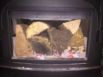

Just loaded both Ashford 30's. This one, on a 15 foot chimney, will be run with dial set around 2:45 and will cruise 24 hours:
[Hearth.com] 2015-2016 Blaze King Performance thread (Everything BK)
This one, on a 30 foot chimney, will be run with dial set around 4:00 for 12 hours:
Both loads are mostly oak, and that big split on the left must be 10" on the long sides, as I used to split mighty big for the Jotuls.
Yes, I know I have the big stuff in the stove I want to run fast, but I've found I don't need to fret much over sizing my splits to my desired run time, in these stoves. They run at pretty much the rate I set on the thermostat, in almost complete disregard for the size of the splits.
No, that's not green wood in there. I'm cutting 4" off every damn last split of 20 cords, to make them fit the smaller fireboxes of these Ashford 30's, so you're just seeing the fresh cut ends there. The Jotuls took 20" - 22" splits.

No, that's not green wood in there. I'm cutting 4" off every damn last split of 20 cords, to make them fit the smaller fireboxes of these Ashford 30's. The Jotuls took 20" - 22" splits.
