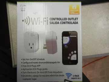

Any ideas for converting the existing blower control to a remote control? The stove is in a deep alcove and the blower knob is difficult to reach.
I picked up this item to control a couple items. Probably a way over the top tech item but was on sale at HD for $8

For two plugs:) Don't tell Brother Bart
I ordered a wifi HomeKit enabled plug, now the wife will be able to ask Siri to turn the woodstove blower on and off.
In addition the ceiling fans all have remotes with temperature setting so they activate when rooms get to preset temperatures.

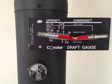

The red fluid moves up and down the tube depending on your draft. This one mounts to the pipe so I can constantly monitor my draft on different setting and in different weather conditions.
