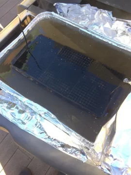

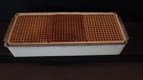

Boil the cat day
  • [Hearth.com] 2016-17 Blaze King Performance Thread (Everything BK)
Water/vinegar WAS clear
