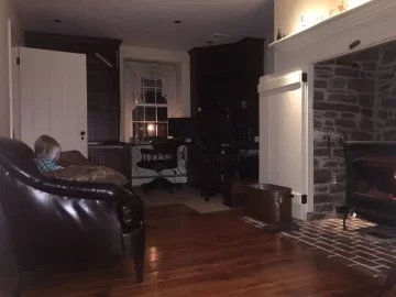

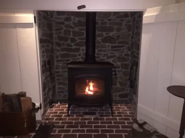

New sofa, strategically placed between office tv and stove.
[Hearth.com] 2016-17 Blaze King Performance Thread (Everything BK)
Reactions: edyit and webby3650
