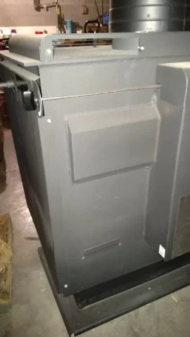

The side sheilds and convection deck significantly reduce the radiative heating of the stove. Take a second look at the photos. The shields temperature is about 200-250F while the stove behind it range from 6-800F! Just a guess but there's probably 5 sqft of sheilds that is not letting that heat out where as my old stove doesn't have any shields. That's a significant amount of heat that is being blocked.

There are two primary methods of heat transfer from the stove, convective and radiation. Assuming the shields are 5 sqft area and have an average surface temperature of only 250F vs say the 600F of the stove behind it, the differences in heat radiation is significant and cannot be ignored. Combine that with no forced air over or between the side shields and you only have a natural convection from the side shields. The shields hold the heat in the firebox. That's what they do and their designed that way. I can hold my hand within 6-8 inches from the side of the stove while it's running on high. Without the sieilds I would not be able to.

Keep in mind, heat is constantly being transfered from the hottest object to the coldest. The stove to the house via radiation and convection and from the house to the outside environment. The rate at which the transfer happens is the key. If and object had more surface area and temperature then it will have a higher heat transfer rate. That is why those shields make such a significant impact on heat transfer rate.

It's interesting. But hasn't been the case for me. My summit has shielding on it and it is literally a heat hammer, as I've mentioned before.
Just imaging how it would be without them.
Why haven't you pulled the shields yet? I can't imagine you need them for CTC if you had the old stove in the same place.

I know always there is something to learn and this is one of those times. I thought that the shield helps those ones with tight clearances but still giving you the heat out of the box just on different direction. the heat in blaze king with shields is redirect it up where it mixes with the heat from the top and at the same time the amount of heat is greater volume. more if you are using the fans. if not using the fan still radiating up. Other stoves with shields has opening pointing forward where the heat is redirect it into the room avoiding overheat walls and objects
No doubt! See what that baby will do! The only difference you will see though may be imagined. The heat isn't being magically removed from your home. It may just be relative, warmer next to stove with your old one, now the whole house is warmer. But less radiant, more convective. Who knows, the heat isn't disappearing into thin air though.

The way it was explained to me by Chris was that the shields serve two purposes. First, they insulate the firebox to help maintain a high temperature combustion chamber to promote combustion efficiency. Second, they decrease the clearance to combustibles. In BK's eyes they are not to be removed.
Honestly I'm not surprised they would tell you not to remove them. If my warantee was no longer valid I would entertain that thought (not before I try the BK fans though). There are gaps in the tops of the shield to allow air flow up between them but the fans do not circulate air under them. Only the convection deck is purposely constructed to increase the convective transfer by blowing air between it and the stove top. Here's a closer look at the sheilds.
