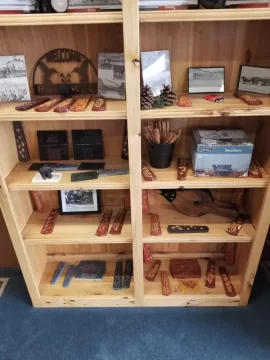

Hey folks, just walked into All Season Heating, up in mountains of California,
and look what I found!
530-257-7202
Blaze King Ceramics!

Someone is copying your grade school art projects?
Nope....pulling them off Stoves from Stove change out program. They are quite expensive if you can find them....
Chris
They're not easy to find. Last time I saw a full set on eBay they were going for about $50.
