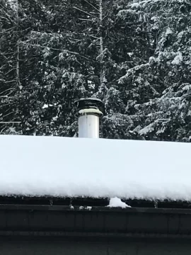

Even with 500 degree flue temps, even in mild Washington, we still get creosicles. This is more like yellow snow really.

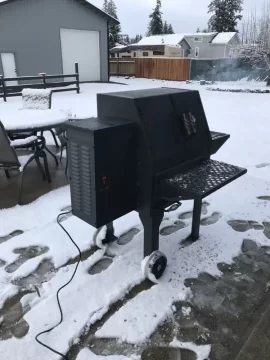

The pellet bbq is cranked up for some tri-tip too.

Man, are you serious with that "pellet smoker?"
Get yourself a "real" offset stick burner and kick in a cooler of beer cause you ain't gonna get far from it until the foods ready.;)
A little jealous of the tri tip though. Can't find it in my area.

Don't eat the yellow snow HB
Reactions: Highbeam
Is that snow from today. We just got a 5 minute squall. Nothing stuck, but the wind has been blowing steady at 25-30mph.
