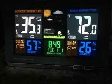

8 below now high of 7 today in northern Wisconsin 5 below tonight the big King loafing along keeping the little cabin toasty warm. Strange winter here too fairly mild, one night below zero and 40 by the weekend.

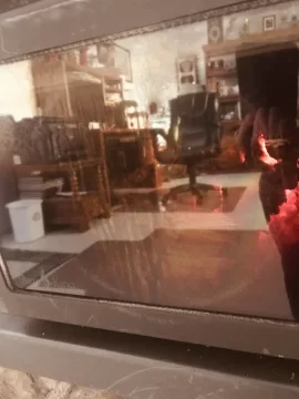

BK insert door glass? Here are some pictures of my glass door with a large circle dead center. You can see where I stalled the combustor. I can clean the glass and circle disappears but after hot fire this circle will come back. My guess in production they use a suctioning device to set glass on just a guess. It’s no big deal just curious?

View attachment 237150 View attachment 237149 BK insert door glass? Here are some pictures of my glass door with a large circle dead center. You can see where I stalled the combustor. I can clean the glass and circle disappears but after hot fire this circle will come back. My guess in production they use a suctioning device to set glass on just a guess. It’s no big deal just curious?
I don't have that. Why would a suction cup leave a permanent mark? Also, I don't know that stove windows are cut from large sheets, as they are not glass. (But maybe they do get cut the same way!)
Industrial glass cutters do use mineral oil. If that is baked on mineral oil, maybe you can scrub it off with vinegar and a nylon brush.
