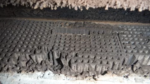

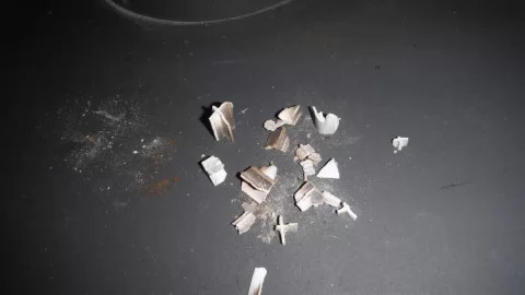

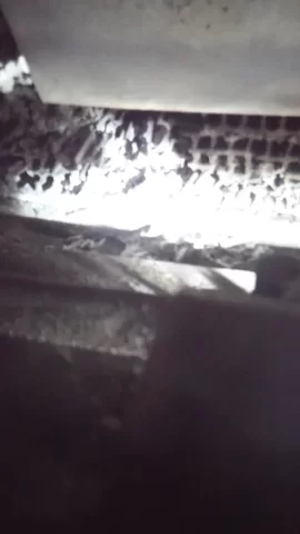

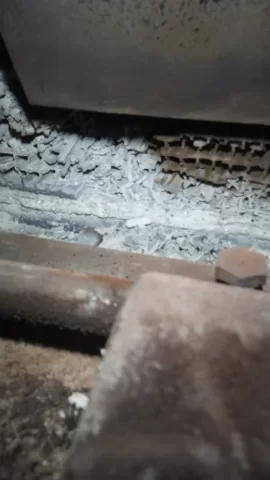

Houston I have a cat issue.
Hi all I don't post to often because I don have too many issues that is till now. I moved the Princess out some so I can do a real good cleaning before the heating season. I removed the stove pipe and went to vacuum the fine powdery ash from the top near the by-pass plate and saw that my cat is ruined. I posted some pictures last year of some crumbling I notices in back last year well now it is about 30%-40% destroyed. Here are some pictures the stove was bought new by me in 2015 from a dealer in Bangor Maine. I tried calling them but they have either changed their name or been bought out by someone else. I left a message hoping for a call back Monday but I can stop by. Because to be honest I don't even know if the new people sell stoves or flowers? They said formerly "McVettys" so who knows.
The warranty says the original cat is warrantied for 10 years so we will see I guess. To say I am very unimpressed is a huge understatement. I was really hoping to get at least 7-9 years before I had to get into repairing my new stove. Now before I post pictures I know people might ask a bunch of questions. Yes the door gasket is in good shape and I do a dollar bill test a few time during the season and adjust if need be. Yes the by-pass is adjusted as well the dollar bill pulls through but with some real resistance. The wood is seasoned 2 years and split into 1/4s at least and some time 1/6s moisture content between 11% and 14%.
[Hearth.com] 2018-19 Blaze King Performance Thread Part 1 (Everything BK) [Hearth.com] 2018-19 Blaze King Performance Thread Part 1 (Everything BK) [Hearth.com] 2018-19 Blaze King Performance Thread Part 1 (Everything BK) [Hearth.com] 2018-19 Blaze King Performance Thread Part 1 (Everything BK)
Im sure the dealer will find a way to make it your fault, not sure what the average life span is, but I bought a spare for the princess just in case. Shopping around for one for the ashford.
Jeff. The cat is under warranty. Give BK support a call on Monday after noon your time (9am PDT) or contact them via the web form stating you have a warranty issue with the cat.
509-522-2730
(broken link removed to http://www.blazeking.com/EN/contactus.php)
Begreen Really?
That would be a much better route I think. I don't want to get all upset with a dealer refusing a claim,...that is if they do refuse it that is. Your idea sounds like just what I need to do. Thanks
That CAT did not get that way under proper operation and fuel source, sorry !!
I am hoping that will not be the case I just would like a no hassle replacement cat. I did a lot of research before I bought this stove I just hope for the best I guess.
I am fairly sure that if you have your purchase receipt the mfr will honor the warranty even if your dealer is out of business. I guess I don't know that, but I would be surprised if they didn't.
That's a ceramic combustor isn't it? It is not a failure mode I have seen before, no help from me there.
Thermal shock can destroy a cat. Did some wood get put in the stove that was frozen solid, maybe with some ice on it, coming directly from outdoors?

The cat has a lifespan of about 10,000 hrs. For some folks that is 2.5yrs of 24/7 heating. For others it could be 6 or more years. It depends on the heating season length and how often the stove is used.

No my wood is stored in my enclosed wood shed attached to the house for months before using it. The firewood for this coming winter has been in under cover now for over a year. I never have any wood go into the stove that has not been staged beside the stove in my kitchen for several days first. I bring into the house a weeks worth of wood all at once the replenish every Sunday morning.
