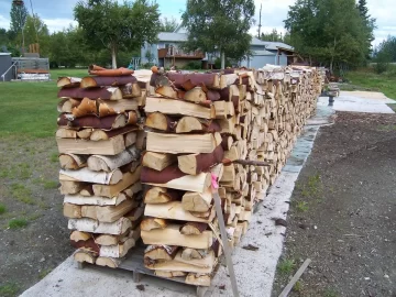

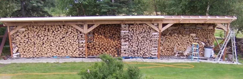

Is that where you put the wood right after its been split or is that wood thats been stacked somewhere else for a year or two?
I have it out back in double rows in the open , seasoning. Will put it in the shed this fall (soon) for 2 years before burning it.
& then start cutting to get a new batch out back seasoning.
In Sept , the shed will have 12/13, 13/14, & 14/15 wood in it. Center section now, is this years wood, left side 13/14 & will fill the right section for 14/15 winter with the stuff out back.
you can see the wood shed in this pic, in the background just above the row on the right:

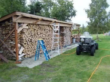

When full now just over 15, with the new eve I can add another row (1 cord +) to each section. 18+ cords total.
17" splits, each section 16', 7-1/2' high average 4 rows now (to be 5) 3 sections
1.4 X 16 X 7.5 X 5 X 3 ÷ 128, (less some side overhang)

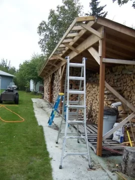

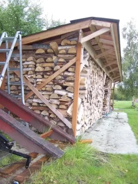

dave, that's almost exactly what I was planning to do to mine. I think I'll take off the fascia first and sister some 2x into the existing though, then maybe a little bracing and put the fascia back up. I'll need a few 2x, some OSB, 15lb. tar paper, and some shingles.
Keep the pics coming. Always interested in how folks build their stuff.

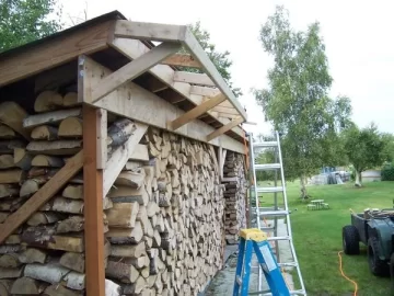

I toe nailed on some 15" 2X4s on the face every 24" , then 12' 2X4 end plate (4) then added some braces up from the header, every 6'.
Added 19" wide 1/2" cdx. Nail gun a great tool
was strong enough to hold me so should handle the snow & wind load.

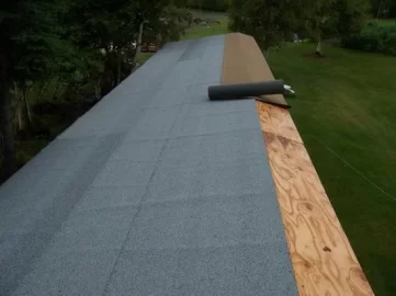

Wife says now that it's done, it needs painted. (have to put on the roofing yet)
