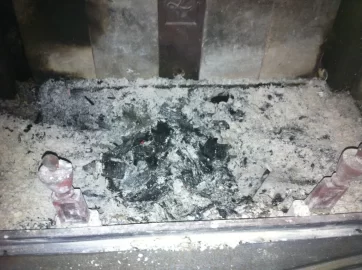

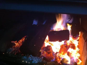

I was able to let both stoves run last night. These pictures are from this morning, I loaded the Ashford at 7 pm and the Cape Cod at 9 pm.
This is what was left at 8 am.
The first pic is the cod in case anyone was unsure.;) Both were loaded with 2 year old white Oak from the same stack. Ashford stovetop was 350 and the Cod was un-measurable.

About what I'd expect to see, gonna take a lot for someone to knock BK off the throne in terms of burn time and usable heat output.
I wan't too surprised, this Cod can do better on occasion but everything has to be just right.
That's a prettier fire view than I was expecting at 13 hours - does it have some flames throughout the burn or mostly coals?

It has flames the whole time on settings 4-3, other than that its mostly just coals.
A valuable comparison post; excellent! (And no surprise to us BK owners, either). I loaded my King at 7 pm last night, and at 5 am this morning stovetop was 450::F. Outside temperature was -2::F this morning (yes, really...), and house was a normal 75::F. And I didn't put any wood in the stove, either. I will load it again tonight for yet another (yawn) exciting 24 hour cycle!
