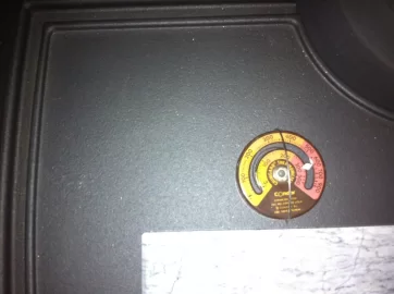

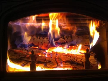

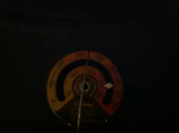

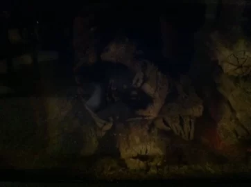

I had posted this in another thread, but in case others missed it. Here is the BK Ashford running on med-Low and then the Cape Cod on medium low. Both have similar stove top temps. Although the CC has a beautiful fire, it's easy to see why the BK's burn times are unparalleled.

Thanks, I fixed it so the pics can be enlarged.
You fixed it alright..........You made the Cod look awesome and the Ashford look gloomy.........hahaha JK ;)
You could have at least painted a fire on the glass of the Ashford.==c
+1 on that Cod fire show
I suspect the Ashford is like any cat stove. It will have an excellent fire show, if you turn up the air and make it burn as fast as the Cod. I can have a great fire show if I want to settle for 8 hour burn times, but going for 12+ hours requires turning the air down to where it's mostly just glowing, with a few lazy / whispy flames in the back.

Ok, I've got a question -- and maybe it's for Webby. If both stoves were sitting at 350 degress but the Ashford was turned way down and the Cod was running at full tilt, wouldn't the Ashford get way hotter (and dump more BTUs into the house) if it were turned up?
How does this work? The wood only has so many BTUs to give off regardless of which stove it's in. Is the Ashford way more efficient than the Cod? If one believes the ratings, the Cod should be almost exactly as efficient as the Ashford.
Webby can surely answer from direct experience, but I can answer from theory and indirect experience. The difference in efficiency will not be noticeable to anyone, comparing a single burn cycle. These numbers are measured as best they can under very specific circumstances, and stove designers test and tune their stoves to achieve the best numbers under these specific circumstances. It may not translate directly to your wood, your install, your house. However, a more efficient stove may burn less wood over the course of an entire heating season, something that is actually measurable by the user.
Now, if the Cod is running full tilt and the Ashford is turned way down, I suspect neither stove will be at 350F. So, I'm not sure I understand the first half of your question. I will say that your house has a given rate of heat loss, for a given outside temperature and wind speed/direction. You need to put BTU's back into the house at a rate similar to the loss, or your house begins to cool. The advantage of a BK is that it simply has a wider range of burn rate, and so you have more control over the rate at which you're putting BTU's back into the house. You correctly assumed there's a fixed number of BTU's in a given load of wood, and all you control is the rate at which they're released, so (minus a small discrepancy in efficiency) both stoves are putting the same overall BTU's back into the house. However, do not forget that your house loses BTU's at a rate proportional to the difference between inside temps and outside temps, so keeping your house at a constant 70 will mean losing slightly less BTU's than cycling up to 75 and letting it fall back down to 70F. If outside temp is 40F, then you're losing BTU's 16% faster at 75F, than you are at a constant 70F [1]. This also have a noticeable effect on yearly wood usage.
[1] - dT = 19.4'K vs. dT = 16.7'K yields 16.2%

The first half of my question referred to the photos posted by Webby. They seemed to show both stoves running at 350 degrees, though the Ashford showed barely a glow and the Cod was running full tilt. So it seemed like the Ashford was running way more efficiently.
Thanks Joful. I'm amazed by the level of knowledge in this community.
Both stoves were at about 600::F.
Great. Same question for you, then, Webby. How does the Ashford manage to do it without any great blaze? Would seem to indicate the reported efficiency numbers, which are nearly equal, cannot be accurate. Am I missing something?
We were just discussing this on another thread. The Ashford is more efficient due to keeping more of the heat from going up the chimney. If you measure the flue temps of the CC and the BK in Webby's photos, the BK temp would be cool enough to put your hand into the flue (or closer to that) and the CC would scorch your hand. Isn't that true, Webby?
Also, the BK at 600F is not really the same as the CC at 600F. The Cod is putting out more heat, as the entire stove is getting pretty hot and a ton of heat is coming out of the front glass. The 600F on the BK is just the area where the combustor is. the rest of the stove is cooler than that, so it's not really a "fair" comparison that way. However, over the entire burn cycle, the total amount of BTUs released into the room is much larger for the BK than the CC.
The thing I'm confused about as well, Parallax, is how the EPA efficiency rating for the BK and non-cat stoves can be anywhere close to each other. Efficiency, at least the HHV, should be a measure of the % of heat content of the wood that is released into the room. The balance goes up the flue, is not combusted completely by the stove, or is used to get the wood up to temp, drive off water, and get the flue gasses up to temp. It seems to me that the real efficiency of non-cat stoves must be below 70% and the BKs must be closer to 80%. I don't think the EPA efficiency numbers are believable? The emissions numbers (grams/hr) are probably pretty good numbers as some sort of avg, as that is easier to measure.
This is correct.
