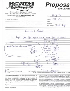

Also, if you get a chance to look at the proposal I posted in my reply to Ansorge, tell me if you think it's reasonable. Really appreciate the feedback; it's so helpful.

Lastly, what do you think of the attached cost estimate to install this stove? Someone said it seemed high. You do these installations so your input would be really helpful. It includes not only the enamel finish but the blower and quick start feature. One location is $1,000 more than the other because of the requirement to bend the pipe out through the wall and then up as opposed to running straight up. Obviously it would be better to go straight up but the bending would allow us to place the stove where it would be most attractive and central. We're starting with nothing so it also includes the pad under the stove, which I've not yet seen but was told is in a tile similar to our entry way.

Webby 3650 would be better at judging prices, but paying 4300 for the stove with out the fan seems high. Also, do you need a pad? The T seems high to me but I've never purchased one.
I do need the pad since the installation would be over a hardwood floor. $600 seems like quite a bit but we did ask for tile so maybe it's reasonable; I'm not sure.
It feels like he's charging top dollar for everything. But maybe it's the going rate. I don't have the expertise to know.
I'm trying to get an estimate on the Ashford and that will help me compare, at least apples to oranges.
When I looked at one here in Minnesota, I thought it was 3500.
That's the right price. Believe it or not but Lopi wants an extra $900 for enamel! These prices aren't too bad, although it's common to give a little discount if you are getting the entire package. These are prices are full retail+.
They claim to be giving me $200 off. There is another dealer I can check with, about the same distance from my home. If I decide to go with that stove, maybe I'll invite him out. For now, I'm trying to get the BK dealer to give me a quote, including installation. He's quoting $2595 for just the stove (in matte black). If the CC is $4291 with the enamel finish, that means it's $3391 without. That's $800 more than the BK. The Ashford is sounding better and better.
He is, tis the season. This is their busiest time and a lousy time to be shopping for a new stove. Check out Tom's shop for comparison, but post the results in your own thread. ;)
Will do, though I don't imagine I'll have them come out and do an estimate unless that's the stove I want to buy.
