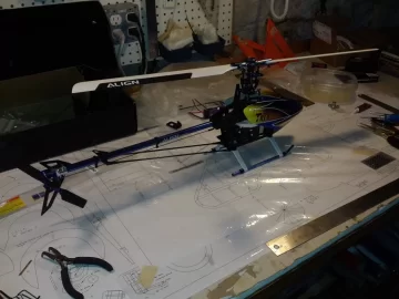

That frame is all carbon and aluminum with some plastic bits. Only took an hour to get this far.
Next step was building the rotor head. This took over 2 hours of fiddling with tiny screws, greasing bearings, loctiting everything, measuring and aligning. Once its all together there will be more hours of setup, alignment and balancing.
  • [Hearth.com] Cant let webby have all the fun
Took a break to pop on the blades and tail boom to get a look. That's a 12in ruler.
This is a "medium size" electric, and flies on a 2200ma 3 cell lipo battery. These come in sizes small enough to fit in you palm all the way up to monsters with 6+ ft rotors running on gas.
