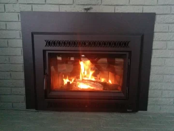

Thanks everyone for your suggestions. I ended up getting a Lopi Large-Flush Hybrid Fyre and I'm really happy with it. I'm looking forward to a full heating season, but so far, it's great.
