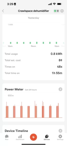

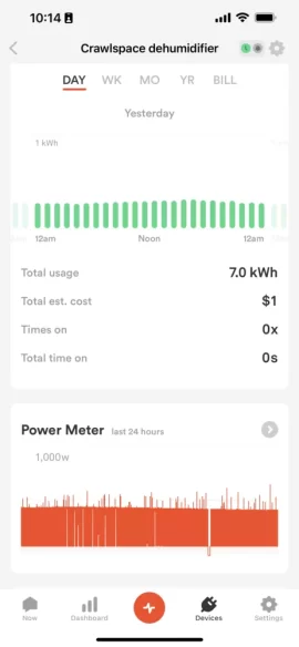

Been playing with schedules and I am currently at 2 hours OFF, 1 hour ON to keep the humidity at around 53%.

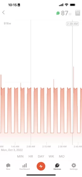

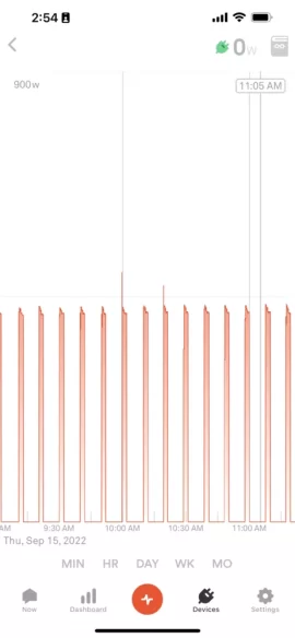

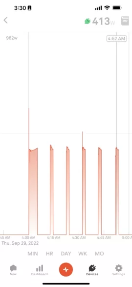

I think the dang unit's meter is messed up, still does the same thing, just now it gets turned off:
It still runs the same pattern of off and on after a 2 hour break:
SO how many times does it cycle on/off during the on period? 48 times in a day seems like alot. If you only have it running 1/3 of the day for an hour each time. Have you asked the manufacturer?
