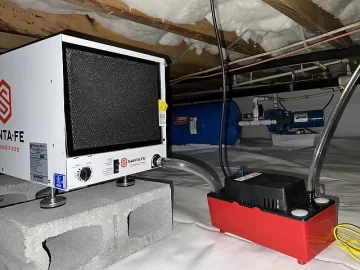

Got everything done and sealed up and the dehumidifier installed.

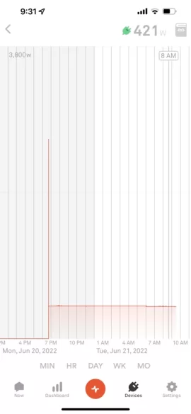

I went ahead and installed my HS110 last night so Sense can start tracking power to the dehumidifier and it is drawing a constant 420w of power, so by my napkin calculations at my current rates it will cost me $45/month or $545/year. Quite an energy hog, but if it works to keep the mold down then so be it.
I am kind of curious, I could set a schedule to have it turn off and turn on, once I have let it run for a few weeks nonstop I will look more into that if I can reduce use during the night or if during the day would be better? My power rates are fixed day or night, short of an increase happening this month.

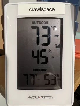

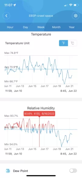

Waiting for the “right” time to do mine but seeing RH values over 95% makes me think it should be sooner. But it’s been this way since 1968. No real issues that I can see yet.

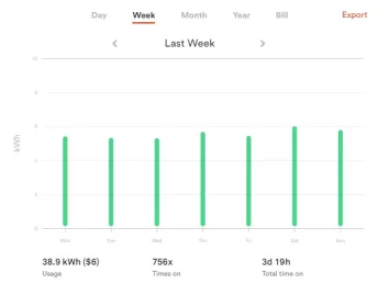

Things are starting to level out, the dehumidifier is running for around 8 minutes then shutting off for about 6 minutes so my costs have fallen. I now have a manual probe down there to keep track of things, it hovers around 45-47% the times I look at it.
My electric costs for the dehumidifier have dropped to around $25/month since I turned up the humidity from 40% to 45%.

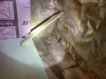

Looking for opinions/confirmation but is that black mold on the blocks? Though it was just dampness until I got up to it, now I’m leaning towards I need to bleach it...
I'm no encapsulation expert, but if that's going to be on the outside of your barrier then I'd think you don't need to worry about it. There's tons of mold and other fungus that lives in the ground anyway and it will just come back due to the high moisture level.
I would have a pro come and look at it and they will use the appropriate chemicals on it and be able to figure out how it is growing and how to eliminate it come coming back.
