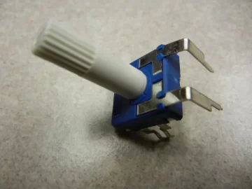

You said you change the pot, did you also change the one on the temp control?
Do any of them Pots have a manufacturer's Part number on them?
or a brand or anything?
What is on the ones I replaced is Spain 257, same as what I got off Ebay. 100k
  • [Hearth.com] harman room fan
Good to hear that you got your heat again. To bad that a third of this years savings is going to a 4 x 5 piece of tech.
