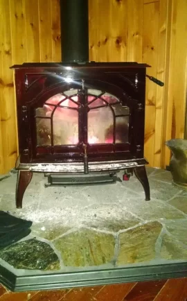

Maybe not the best pic but this is what my isle royale looks like 2 1/2 hours into the burn. Secondaries have been going the whole time and usually continue for a couple more hours.
My isle royale almost never gets secondaries like that. The Yosemite does. Where the flames are shooting out of the tubes but the wood is almost dark:(
What stove top temps are you running your IR at?
I try to keep it in the 600s. It will occasionally get up towards 700 but I try to keep it around 650. What do you run yours at?
About the same. I have the air shut all the way down around 625 and it will usually creep up to 700 or a bit over then come back down and settle around 600-650
