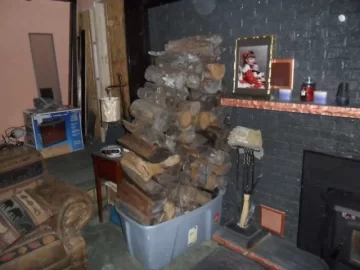

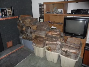

Get yourself a few largest tote bins you can find at Walmart, and store some wood in those in the stove room. In a week or 2 they will be much drier and you should see a big difference in both ignition time & how they burn.
I was laid up with after surgery in 2010, and did just that. See photos.

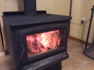

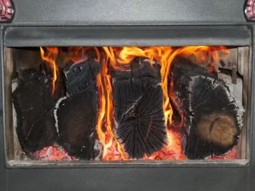

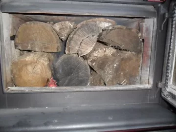

Here is how I load my Summit to give you an idea of how to achieve long burn times. I load 2x per day approx every 12 hours or so. The wood must be dry to get optimal heat from it.
