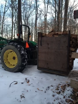

I welded a frame together and used 2x12 treated on floor and 3/4 inch plywood on sides. its 4W X 4L X 4H It holds just a little over a half cord. Thats about a 70hp tractor with a loader and it will bounce the front tires off the ground if I go fast back to the house.
