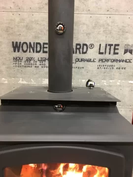

What are you using to measure your stove top temps? IR gun or magnetic meter. Magnetic meters can be off by as much as 200*f . 700 stovetop is mighty hot you would likely not be able to put your hand close to the top for more than 1-2 sec.
I have an old VC magnetic meter. It is kind of old and will replace it. What brand is most reliable? Also, I had a Ryobi IR gun but it went MIA with my teens at our outdoor fire pit.
Ir guns are most reliable. You can get them on sale for 20.00 sometimes. And they are fun to use in many applications. For example the temp of your pet resting next to the stove!!!
i have never found a magnetic thermometer that read Same as the IR.
Ryobi drills, saws, etc. are cheap and known to be okay for the occasional job around the house for homeowner use, and while I quickly picked up their IR gun a few years ago on A whim, I use Milwaukee, Dewalt, Snapon, and other brands when buying tools.
I will get a Condar Inferno magnetic thermometer as well, unless there is a better one out there.
From what I read here Condar thermo will keep its calibration for a while. I used to use the cheap magnetic ones and eventually trashed them all. I have one old one still stuck to the VC griddle. The numbers peeled off and I never pay attention to it. Flue probe thermometer and the cat probe will tell you what mostly goes on in your stove system.
Condar inferno magnetic for me! As good as any.

I do have. Cat probe- that’s how I know my cat hit 1530.
I have double wall stove pipe so a magnetic is inaccurate for the pipe, and I’m concerned about drilling a hole in the stove pipe for a flue thermometer.
I just called Olympia and the tech people said I CAN drill a hoe into the stove pipe and use the Condar Flueguard thermomete.
No problem; Smoke doesn't come out, a small bit of air gets sucked in by the draft.
