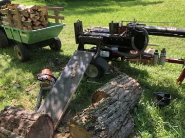

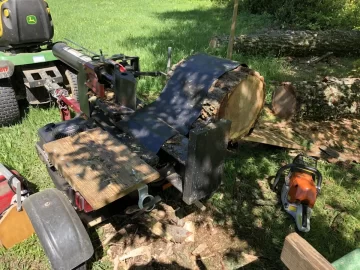

    Being an old man with bad back and old splitter, I needed a way to get some of the larger logs up on my splitter.
    This little ramp seemed to do the trick.
    Wood ramp and a piece of roll roofing nailed at the top made getting these 20" white oak pieces on the splitter easy.

    That's just flat brilliant. I tell you what, even on a good day I don't think I could lift that log on the splitter. Great idea!
    What kind of roll roofing is that?

    Thats the same way my grandpa does it. He uses a thick plank of oak to roll the monsters up onto the splitter, no roll roofing though. I also use a plank when needed for super mosters, although I can crank the jack all the way down on my splitter and get the toungue/wedge area almost completly on the ground and just roll stuff right onto it.

    Sorry, I should have said rubber roofing, it's just a scrap from another job.
    Anything strong and flexible should do, you just grab it at the bottom and the log rolls right up.
