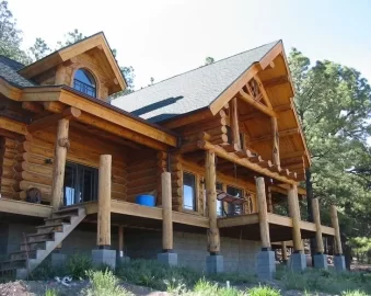

Okay, I think I may have finally have goten a pic of the inside of our log home resized to stick!.
As I mentioned, this is an EXTREMELY open floorplan. I'm not really sure how to figure the livable sq footage because they count only the actual floorspace. If the upstairs loft was all filled in with "livable" sq footage, as opposed to open air space, the sq foot amount would be even higher than it is.
I know I have a LOT of space or "volume" of air to heat which is why I don't want to make a poor choice of stove. The open three sided penninsula fireplace in the picture (not rocked yet) will be a feature in the home, but unfortunately worthless for heat.
I know your thinking "why not convert the large free standing fireplace into an actual heating unit"... That makes TOTAL sense!!.. I know, but my wife REALLY wants this "decorative" feature in the house and wants all three sides exposed.
I plan on putting a large wood stove just in front of the vertical log post supporting the second floor. (in front of kitchen). As you can see from the pic, its a straight shot to the roof with no obstructions. There are also three ceiling fans ready to blow heated air back down.
SO, back to the original question, do you guys think I will be able to heat this area with a wood stove?
That is possibly the best house to heat with a stove I've seen around here. Get a big one though!! A nice big Defiant would look real nice there. Go for it. Oh, and stop over thinking it. Just pick a stove and install it. At some point you'll figure out that it is a ford vs chevy, or maybe a ford vs a Volvo. A big Englander would do great, it's just not as pretty as the VC. Or maybe it's a Chevy vs a Jag. A big Englander would do great, it's just not as elegant as a Woodstock.
That house is the cure for "I don't want to heat myself out of the room.". Won't happen with whatever you buy. That place cries out for a big Quad steel stove, a PE Summit/Alderlea or the Englander 30-NC. We can tell ya what heats well. Deciding what you like to look at in a stove as "furniture" is 100% a personal decision that nobody can advise you on.
But as we say at the poker table "Think long. Think wrong.".
And as to wood consumption, you are going to burn a bunch of pine no matter what stove you buy. You are going to burn a bunch of anything you use to heat that space. Be it electicity, gas wood, old tires or whatever.
I've been in a few log homes that size that were only heated with a wood stove. They were vacation homes and we did drain the water lines when we left but it was set up for that so no big deal. When you go there they were cold and the big stove, the biggest country stove in this case, took so many hours per 10 degrees but it was certainly possible to heat the place. Now to be fair I will admit that it was cold until it warmed up but once the logs were warm and the air was warm we were able to turn the stove down to a more moderate burn.
A single large woodstove can easily heat that space. It will be work to keep the fire going but that is the same for anyone burning as primary heat.
Go big here on the stove. I use a 3+ CF firebox LOPI and evergreen firewood and would not want a smaller stove at all if trying for overnight burns on our less dense forest wood. You will need all the room you can get to fit in loads of wood. This will not only allow overnight burns but also less frequent fills during the day.
One thing I forgot to mention, when you look at this picture, you are only seeing about 1/3 of the inside area (due to the room configuration and where I was standing to take the pic).
I will attempt to post another pic of the outside to give you all a better perspective of the volume of room to heat.

If she doesn't like the looks of a steel Quad then she won't like the 30-NC either. There seems to be only one woman in exsistence that loves the look of the 30 and she is taken.
Edit: Gotta make that two. Her sister was here last month and really likes it too.
What a gorgeous place you have there. I think that Defiant will look and work great in there.
