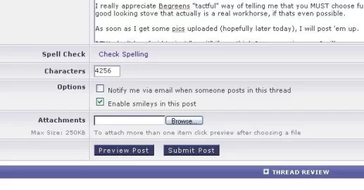

I am not used to a forum that does not use html codes to post pics and lets just say that I am a "natural" blonde...(really)!. so it may take a bit to figure out how to post up some pics but I will take some pics of the log home (inside and out) so you all can see exactly what I am working with.
I really appreciate Begreens "tactful" way of telling me that you MUST choose function first, then form. Even though I do get that, I still would like to find a good looking stove that actually is a real workhorse, if thats even possible.
As soon as I get some pics uploaded (hopefully later today), I will post 'em up.
If you want to post a picture, first downsize it so that is about 800 x 600 pixels or less. Then, use the "Post Reply" button, not the "Fast Reply" button. At the bottom of the reply screen you will see a section for attachments. Click on the "Browse" button to link to the picture file on your computer. The click on "Preview Post" button if you have another picture to post, and if not, click on the "Submit Post" button.

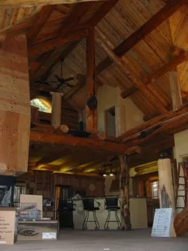

Okay, I think I may have finally have goten a pic of the inside of our log home resized to stick!.
As I mentioned, this is an EXTREMELY open floorplan. I'm not really sure how to figure the livable sq footage because they count only the actual floorspace. If the upstairs loft was all filled in with "livable" sq footage, as opposed to open air space, the sq foot amount would be even higher than it is.
I know I have a LOT of space or "volume" of air to heat which is why I don't want to make a poor choice of stove. The open three sided penninsula fireplace in the picture (not rocked yet) will be a feature in the home, but unfortunately worthless for heat.
I know your thinking "why not convert the large free standing fireplace into an actual heating unit"... That makes TOTAL sense!!.. I know, but my wife REALLY wants this "decorative" feature in the house and wants all three sides exposed.
I plan on putting a large wood stove just in front of the vertical log post supporting the second floor. (in front of kitchen). As you can see from the pic, its a straight shot to the roof with no obstructions. There are also three ceiling fans ready to blow heated air back down.
SO, back to the original question, do you guys think I will be able to heat this area with a wood stove?
