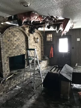

Fire. I would say chimney fire but my mason insists the chimney is fine. :) He thinks that a brace inside the framed wall was to close to the firebox and caught on fire. Fire went up through wall and out the roof.
I had been working a night shift and was asleep when a firefighter opened my bedroom door and said "your house is on fire! You have to get out!"
I said "well I better get some pants on then ". Lol it was pretty confusing moment.
Thankfully a neighbor seen it and called it in!
It was a mason chimney with a old fireplace insert in it. We had been pushing it pretty hard because we were about 15 below about then.

Sketch is fine, very helpful. I'm so glad no one was hurt.
Why the demolition of the current hearth? The fireplace looks pretty large. Are you opposed to putting in a large modern insert assuming it fits and the chimney can take an 8" liner?
[Hearth.com] Woodstock progress vs hearthstone equinox The fire burned down inside the walls behind the brick. About 4 studs worth. Which is basically the whole middle section of the hearth. We will never be able to match the old brick so we are going to tear out the whole thing. Since the bottom of the fireplace is getting demo-ed it gives us some flexibility in what we can do.

Sounds like there were a lot of clearance issues with your flireplace.

View attachment 193337 The fire burned down inside the walls behind the brick. About 4 studs worth. Which is basically the whole middle section of the hearth. We will never be able to match the old brick so we are going to tear out the whole thing. Since the bottom of the fireplace is getting demo-ed it gives us some flexibility in what we can do.
