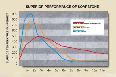

Dude. Give it a rest. The marketing gurus for soapstone companies use the included graph to show that soapstone is smooth heater, not a monster like steel/cast stoves. Aggressive attitudes are not needed. Webby3650 probably knows more about woodstoves than you and I will ever know combined. Getting sand in one's undies over his opinions expressed in a forum is a fools errand.
As for sciency stuff... The area under each curve below is roughly the same. Every stove will throw roughly (efficiency)% of the BTUs loaded into it. Some stoves throw it quickly, some over time. For some people, frequent reloads in a steel stove will get them much more household heat than they could get with a soapstone stove. That, of course, comes with loading more BTUs (aka wood) into the stove.
For me, I don't need intense heat. I need it over time. With that, I'll say my PH has been awesome and I won't look back on my decision to get it. I also won't begrudge someone for whom a soapstone stove is not the right decision.

Those curves look like they chose a small capacity stove to represent steel. Our cast-iron jacketed stove has a much flatter, longer curve. It's more like the soapstone but with a higher top end if you want to push the stove there, but it's not necessary to.
