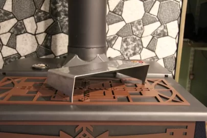

Here's how the hood-scoop sits atop the cat. It's a cool little feature.
[Hearth.com] Woodstock Soapstone Absolute Steel Beta Install
