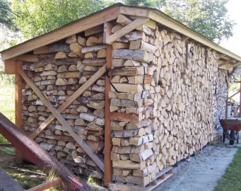

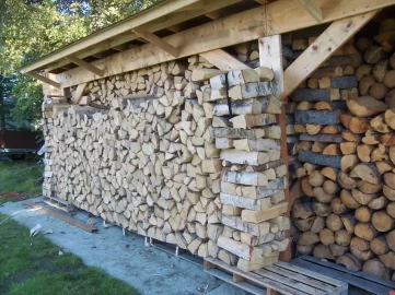

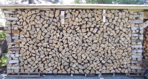

Full section with 6 cord for 13/14.
New row 17" X 16' X 7.5'

I KNEW you weren't kidding when you said the new overhang would give room for another row.

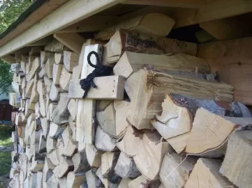

What are the sideways "T"'s for? Looks like you might have those tied into the stack behind.

Dave, I'm curious about that left end. Is it weak or just appears that way?
I tied a rope to the header beam then a knot thru the 2X4, Wedged it tight with a small split to help hold the top of the stack in. (in 2 places)
Several places I wedged in a 3' stick tied into the row behind to help keep it stable.
Stacked 7-1/2' high & being in an area with several earth quakes, I'm hoping it stays there for 2013/14 burn season.
I wedged it into the vertical 4X4 & the row behind a few places, it's a bit crooked but stable for left & fight movement & then I tied a strap 2/3 rds up,around a few of the cross stacks to the shed frame to hopefully keep it from falling forward.
I may put a 2X4 in there if when it dries a bit, it gets loose.

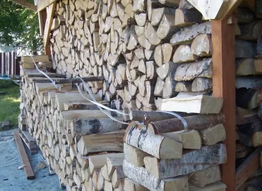

Mid way I put in a strap all the way across the row & tied the 2 cross stacks together then stacked on top of the strap to hold it together.
Worried about stability, especially when 7-1/2 feet high.

So thats the secret.... running that nylon banding from end to end....tricky very tricky. Do you normally do that?
Yes, When stacking over 4-1/2 feet high.
This has to stay there for over a year, I'm hoping .
