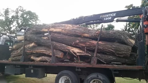

O.k. So here is early into 114F day cutting, splitting and stacking. Got to love Honey Locust!!
Reactions: mwhitnee and Ashful
$50.00 per truck load....
Don't put off until tomorrow what your wife wants done today!

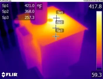

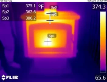

Sort of wonder why in first two images the flue collar is not as hot in 3rd image.
With the angle of the photo, looking down, I suspect the bright flue collar blends in with the bright stove top. The glass still looks hot.
