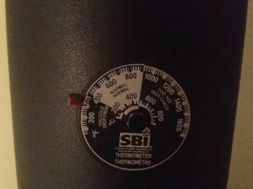

I know there was some discussion here a little while back about flue temperatures being very low while the cat probe said active. Out of curiosity I added a flue probe. I also found very low flue temps even though the cat was clearly active. Maybe I have a bad probe too?

I ran mine last night with a load of more basswood. Flue temp was reading about 250° and the thermostat was between the 3 and 4 o'clock position. The cat was a little over the 4 o'clock position and glowing red. I don't think all these flue probes are bad ones. I just don't think there's much heat going out the stack.

I installed that same probe 18 inches up. Low burn with cat active I will get 250. Wide open doing a burn in of a fresh load with cat engaged it will get up to 600

I have been running consistently between 225 and 350 deg temps in my flue about 16" up from the stove collar, the only time I go above 350deg is when the by-pass is open waiting for active range on the cat, or running full blast with the cat engaged for 45min on my weekly burn off's

Your numbers are normal....my King can go a bit lower, around 200....your performance may varying depending upon draft, fuel type and etc., etc.,
