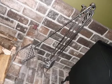

Behold "the claw".
[Hearth.com] 2015-2016 Blaze King Performance thread (Everything BK)
I started with a very cheap made in Viet Nam "cultivator" from Lowes, $4.50, had a handle on it about 4" long with the tines bent 90 degree from the axis of the handle. Back by the shovels and rakes and implements of destruction.
I suppose this thing is made of "steel" but it is the closest thing to wrought iron I have bought in a while. I can adjust the spacing of the tines just with leather gloves on. I brought the times back towards flat too, they're now bent about 45 degrees from the axis of the handle. Took the handle up to 20" so I could reach the back of the firebox without actually putting my hand inside the stove.
Good thing it gets the job done, that wood dowel heats up kinda quick. My goal is to lift the larger coals out of the ash bed at reload time so they can keep burning rather than accumulate.
When it was time to reload I got the door opened, whacked on my charcoals some with the wrangling tool from BK to break them up a little bit, then let the tines on the claw down to the floor just inside the door and pushed towards the back. Took three push passes total, right center and left, and then three pulling passes to have all the big coals on top of the ashes and small coals.
I let it run in bypass with the door closed a few minutes in case I burnt some of the paint off the tines with that little stunt. Then I re-opened the door and loaded on a beautiful bed of coals.
Still playing with the angle to bend the tines to, only used it once so far, but while I am making do with my sub-optimal wood between 16 and 22% MC it should make life with the stove quite a bit easier. True test will be Saturday or whenever I have to take the time to burn coals down again.
Once I am happy with it I'll start fresh, burn the paint off the new piece in an outdoor fire pit and do something about the points on the tines so I don't have to buy new brick soon. I guess I'll be finding out if these will have enough carbon in the iron to take a temper here in the next few weeks.

Poindexter...100% stainless. 6" forks, 1/2" spacing. Radius to cup coals...sides would be great. 30" handle. Made entirely of cut off materials.

Focus on the coal fork issue! I have access to materials in the scrap bin and have welding, cutoff saws and press-brake in my garage here at the house.
I ground the tips down on the bottom edge to minimize brick damage, but the next one I build I think the tines should all be welded to an arched piece, forming a cup of sorts. That way when you shake it the coals stay in the "cup".

There have been several nice ones made by members that I've seen. @BobUrban made these.
