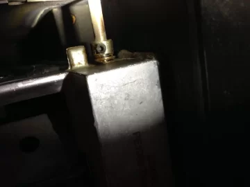

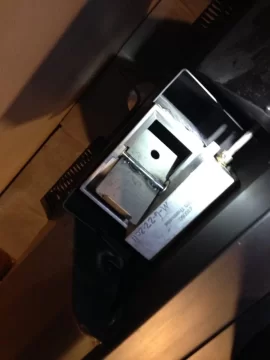

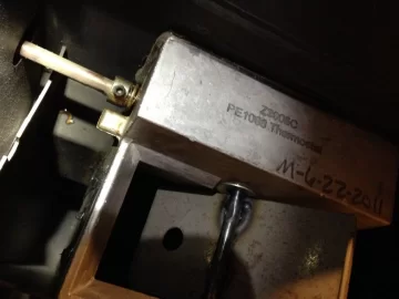

I have the princess so I'm not sure this will work for you but it's very simple. In between the two fans is the thermostat housing. Mine had a sticker on it saying do not remove this cover. It's held on by 2 screws and possibly a blob of silicone. Pull that off and lube where the shaft rotates with nickel anti-seize. If I remember correctly I used a little acid brush. I was told don't worry about reapplying any silicone when you reinstall it. Btw nice swoosh sticker
Thanks Woody made my life easier. Done in ten minutes, turns like buddah...
Plan on doing this once a year or so. I use gun oil (non gumming)on the flapper pivots and high temp antizeize on the operating shaft friction washers. The grease lasts way longer than gun oil on the shaft friction washers which keeps that buttery smooth turning feeling.
A few pics so that everybody knows what we're talking about and one of the most important parts of the BK.
