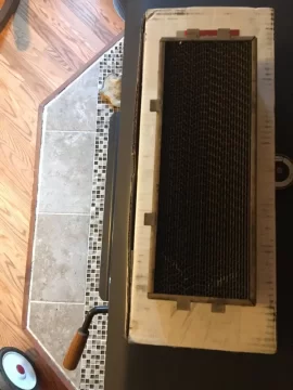

Pic of the new steelcat. I'm going to hold out judgment on it NOT having a gasket for now. The only instructions is "do not use a gasket, just put it in leaving room for expansion." I found that I have about 1/4" gap between the top of the cat and the stove but after an e-mail inquiry was told that was fine.

I wonder what the "official" recommendation is on the cat gasket? To use or not to use? Today I made a pyramid of small splits 6" high and 8" wide in the center of the stove for a short fire. After 12 minutes ,when the flue hit 400, I rolled the damper over with the cat thermometer pointing at "I" on inactive. Two minutes later the Cat thermometer was in the active zone bellowing heat. I guess this amazes me because my previous stove was a "downdraft" type burner and required at least 20 minutes before damper rollover. An early rollover would result in a cat ignite failure and a lot of smoke at the flue cap. Eventually I purchased an electronic cat thermometer so start-ups were not done blindly. A mechanical thermometer could not be used as it was inserted at the rear of the stove. I was not happy with that situation at all.
My steel cat came with a new gasket. I would acquire the required gasket and think that this is another case of a dealer more concerned with profit than making it right. The cat does look like durafoil though.
Agreed, I will get a gasket but am going to try it without just from curiousity. I don't see it expanding to the point of closing that kind of gap but only one way to find out.
The sides are fairly snug but since they advice not to use a gasket I think at least putting a lip across the top of the cat would have been better.
I ordered a steelcat from them too. It will be here Monday. I will see how mine fits. I read that no other gasket is needed
