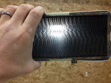

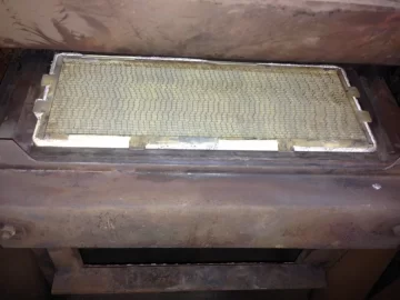

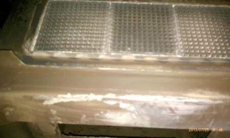

I've had both steel and ceramic cats. I prefer the ceramic over steel. While the steel fires up much faster, I found the cat would go inactive much sooner on the tail end of fire. With my shorter flue, it was more finicky. With my ceramic cat it's almost alway still reading active once it's time to reload. These differences are very minor, but if I get to choose, I'd choose ceramic.
So we have one vote for steel over ceramic. That appears to be a trend from my reading here lately. They must still be placing ceramic in them as to not toy with their EPA certification.
All current model BKs have shipped with steel cats at some point. Only the princess/king have ever used the ceramic cats and usually ship with ceramics. The 20 and 30 boxes have only ever used steel and the new hybrid Woodstocks also only use steel. I've used both wouldn't have a problem with either ceramic or steel. The steel has way more surface area to do work on the smoke than the ceramics so it should be better at it. The steel also should be better able to resist thermal shock which is what usually kills cats.
When manufacturers are trying to hit peak efficiency and minimum emissions they move to steel. Steel costs more so if the ceramics were equal then I doubt the manufacturers would use steel.
All guesses of course. Based on the observations.
Here are pictures of the ceramic and steel for my princess.
