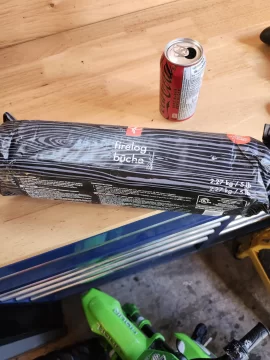

[Hearth.com] Burned about 4 or 5 compressed logs :(
That doesn't show the brand or manufacturer. It may not be for wood stoves. What do the instructions say? Do they say "for fireplace and open firepit use only"?
PS: President's Choice brand?
Ill have to take a look at it when I go back out I'd be surprised if it was for a wood stove.
Its a pc brand here in canada and if u zoom up and read the directions it says use only 1 at a time :(
I tried zooming in but it's too blurry. If they are President's Choice brand 4 hr. logs, I found this online description:
Suitable for indoor open-hearth fireplaces and outdoor fireplaces, fire pits and campfires.
I did find a review in which they said:
These “logs” are primarily made from sawdust, which the manufacturer sources from furniture factories and cabinet makers. That’s mixed with pecan shells, which is why you’ll see a “tree nut allergen” warning on the side of the box. Molasses (yes, as in the thick, goopy syrup you put in your gingerbread) is poured into the dry ingredients to act as a kind of glue along with waxes, creating that “warm your frozen hands in front of the fire” heat effect.
In other words, if they are like DuraFlame logs, they're not meant for a wood stove.
