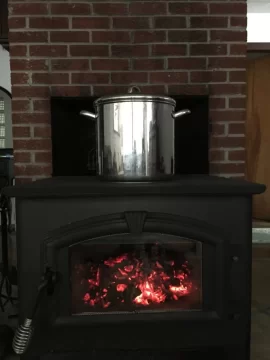

We went for a walk in the mist this morning and put some vittles on the stove for some midday goodness.

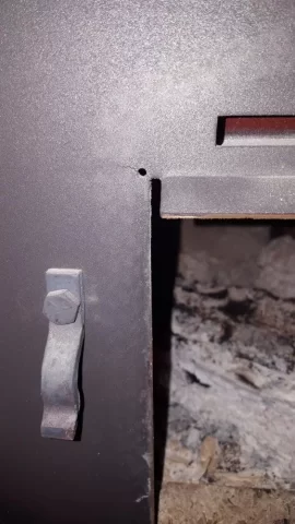

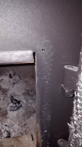

I have a similar model. 2500LN bought at tractor supply. This is my 5th year heating. I have had my stove replaced once under warranty for cracking at the corners on the opening for the fire box( where the door seals against. The new stove is doing the same. I did drill out the ends of the cracks last year and that seemed to stop the cracks. Until this year as one has spread some. This time I will be grinding the corners rounded and weld the cracks along with some reinforcing on the inside. This will wait till spring but will be keeping a close eye on it till then. Great size and works great. I built a 12" high hearth for the replacement stove made loading much easier. Enjoy the heat but keep an eye on the corners of the firebox opening. They were very responsive on warranty and it is possible they have remedied the issues but I remember reading some others having the same problems.
It was possible that it was your review that we read prior to making the purchase. We hoped even though the 2500 and the 3,000 are very similar, they were different stoves. The construction is the same and all the welds appear properly made in that area. We are keeping an eye on the stove, like a chicken hawk, and really figured that once a stove is put into operation we really have no recourse for warranty. Your story, however, does give us hope that the manufacture will stand behind the product if we should need assistance. Thanks for the heads up.
Yes they sent me a new stove and I even finished out the burn season on the old stove. Then sent a truck to pick up the old stove. I know it sounds crazy and may void warranty but rounding the corners may prevent the problem as thermal expansion would be distributed more evenly. Looks like the 3000 and 2500 are really close other than that mine has legs and a shiny door. I agree withe the fasteners used. As I upgraded the bolts on the legs to grade 8 hardware that were longer. The factory grade 5 bolts had maybe 2 threads holding the legs on. Though there were three bolts on each leg I wanted to upgrade as failure would be a bad thing if i was not home or not. I did not however replace the burn tube screws. I wish I would have now. Another thing I did is seal up the ash shoot with some furnace cement and replaced plug as I saw that as a possible problem if a log fell and knocked it out or it started leaking at any time. let me see if i can get a picture of the problems and upload. Not a bad stove and the low rear clearance is the main reason I went with this stove, and well of course price.
[Hearth.com] Country Hearth US Stove 3000 [Hearth.com] Country Hearth US Stove 3000 [Hearth.com] Country Hearth US Stove 3000
Hope that works. But i would not worry about it just keep a good eye on it and their warranty is good just save all info and make a copy of your receipt as thermal receipts don't last. I did the install myself and had to send pictures of stack and components used. This one is out of warranty and I can weld pretty will so I will modify it some
no idea why it posted the pictures twice??? Burn on and enjoy the heat. I will add that this is the only source of heat in my home Around 800 sq/ft and not including basement and walk up attic. all stays warm. Sometimes hot but I can crack a window if needed. Neighbors look at me funny when I let my dog out wearing shorts and flipflops. But they complain about their 4-500$ electric bill.

Thanks for the photos. I would think that the second stove indicates a more systemic problem with the design/materials/workmanship and should still be covered in warranty.
The same exact thing happened to me, I just got rid of the stove, it wasn't worth fighting the company for a warranty problem imo, I also had issues with the secondary reburn tube mounts, when I went to pull the baffle board out I had to take the first two tubes out, the screws that hold the mounting clips just sheered off, had to redrill and tape new holes, it was a huge pain just to clean the chimney out.
Lesson learned, never buy a stove from China, yes the stove provided good heat, decent burn times but the rest was not worth it, I also vented my frustration about the stove cracking in the door corners here and there was a US stove rep that was just a pompous jerk that replied, I lost faith with the company (especially when you see how BK handles there customer issues) that's why I said it wasn't worth fighting the warranty problem.
