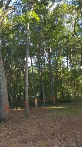

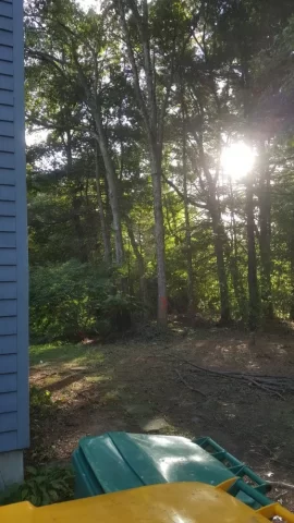

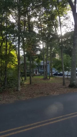

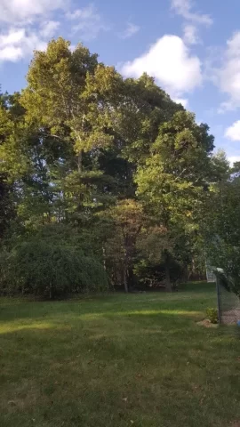

Ok, the tree service will be here for 8-10 hours tomorrow. Last time they cut down 12 trees in 5 hours. And 5 were quite large imo. for a city slicker. Lol. I have 30 trees marked. But about twenty are on the small size. So well see how things go. I will have updated log pile soon. Btw the deal is 2900.00 for 4 guys a 150' crane and a bucket truck. Also they take everything with them. And leave me the poles for firewood. This is in the boston, ma area. Seems reasonable to me.
here is a few pics. just for somthing to look at.

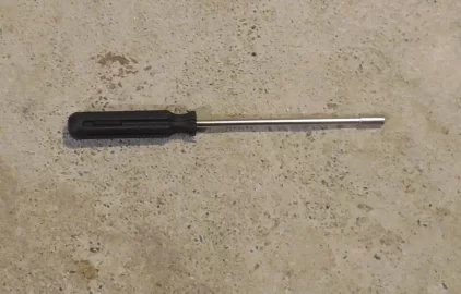

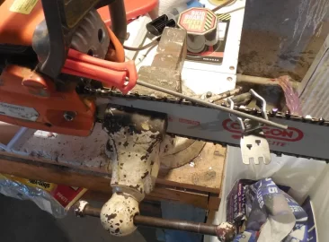

The other pics are of the carb adjust tool you must get. The other of the file/guide you must get. I clamp my bar in the table vise using the teeth to keep it from rotating. I mark one chain tooth with a marker and file one side, turn the guide around and do the other side. Ten minutes with about four passes per tooth.

yep, we moved in in august. and its our forever home. but theres like a 75 trees on 1 acre. so we decided to get it over with quick. while the leaves were still on them. 2900 a day for 5 guys and their equipment. and this is the best deal around for sure. so 3 days later. and we will leave it at that.
