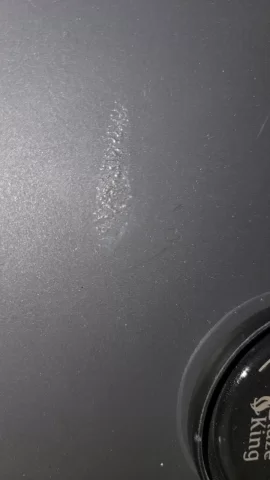

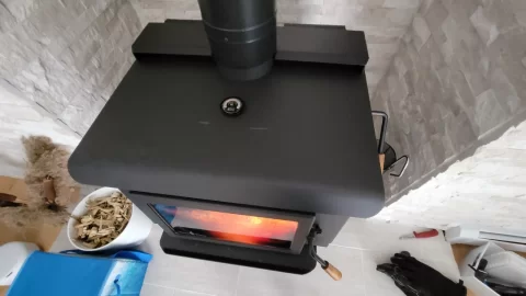

However, this morning I woke up to put a little more wood in and noticed these random marks on the surface of my stove... I have no idea what these are and they were not here last night. 2 adults and I'm the only person operating this stove so no kids throwing random crap on it, and nothing leaking from above.
A little annoyed with how it looks now and we're careful never to put anything on it! But more importantly I'm worried that it's some kind of manufacturing defect? If it's cosmetic it's fine I'll get over it, but I'm worried it's something inside? Maybe an interior weld or something that's showing signs of something?
I don't know... It's seems like plastic but it doesn't come off, it's almost like the steel bubbling up but it's very smooth.
Anyone seen this? Or any idea how to figure out what it is? Stove seems to be functioning fine I have it on right now too, but if this is a sign of something coming I want to get ahead of it. Thanks!

Okay scratch all this.. We just got it real hot and was able to somewhat clean it off, I think the paint bubbled?
This is right where the cat is, so that got very hot indeed. A new cat getting very hot is common. I've not seen paint complaints from that though.
Just strange I been using it for 3 months and have gotten it super hot before... and over night when it was on low it had this paint bubbling? Maybe a bug or something landed on it lol, I'll keep an eye on it, winter is far from over

My 2012 princess is getting older now and I have lost some paint off of the top. Near the edges, so not a really hot spot, but it does flake off in a spotted pattern. Not really bubbles, no lifting of paint, it just pops off in little spots.
The photo looks a lot like something plastic touched the stove top and melted. Like perhaps those curtains! If the pictured damaged comes off and the paint is good underneath then I suspect contact with something.
Definitely agree with you something must have come in contact with it, the curtains are like 20 feet away so not that but I did clean off whatever the "damage" was and the paint seems fine underneath. Had it running way hotter since then and no recurring issue so I think this is a closed case for the most part.
