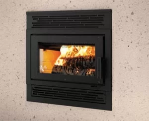

Olympia Ventis HE250:
[Hearth.com] Olympia HE250 vs the Kozy Z42?
Glass surface size (viewing area): 24 3/8″ x 12″
BTU: Up to 75,000 BTU per hour

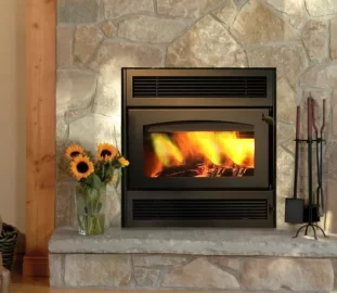

Kozy Z42:
Glass surface size (viewing area): 29-5/8" x 15-13/16"
BTU: up to 60,000 BTU per hour
Thy are both rated to heat up to 2100 sq feet, and have burn times up to 9 hours. I kind of like the look of the Kozy better, as the glass viewing area is close to 16 inches high vs the 12 inches of the Ventis HE250.

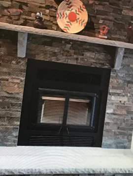

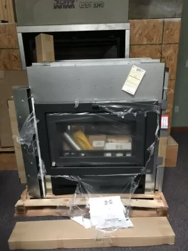

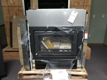

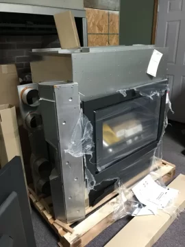

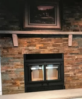

Here is the Kozy z42 installed. The woman who runs their store (wife of the installer), showed me photos of two they just installed in the last couple of weeks. Note, they do have have a mason right now, so the stone tile (actually the same tile and color - just different lighting) they used is the most complex the installer will do until they find a new mason. Also, the owners opted for the double door, I want a single large door for more viewing area.
[Hearth.com] Olympia HE250 vs the Kozy Z42? [Hearth.com] Olympia HE250 vs the Kozy Z42?
From the online reviews, this place seems to be be very quick (2-3 days for full install with tile work), but they are ultra slow when warranty work needs to be done on new units. From what most people said, once you sign the contract, they are there very quick to get out to your house and install is done fast, but if there is a problem, they make you wait a few weeks until they come and fix it.

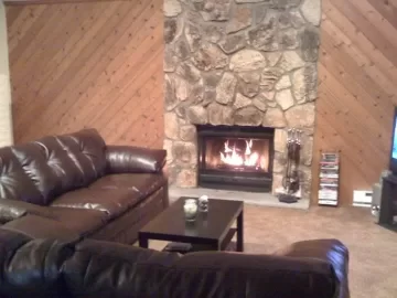

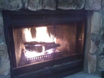

Here is my current PreWay Fireplace in my livingroom.

That all said, I think I am really leaning towards the Kozy K42. It has a large viewing glass that is within 1" height and width of my current Preway opening/viewing area for the fireplace. 29-5/8" x 15-13/16" vs ~ 30" x 17" for my Preway. The Olympia is just 12" x 24.5" Too small.
