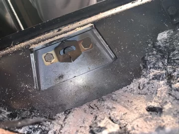

Is there any recommendation on keeping vs removing the little metal part bolted over the intake? Just wondering if it designed to increase flow or not. Thanks
Don’t think I can edit my last post. But also just curious where the stove pulls air in. I have a wind detector that I use for hunting and just trying to see if I have a visible draft being pulled into the stove.
