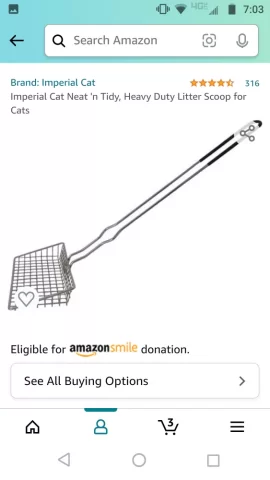

I assume everyone here uses this insert non stop to heat the house. What do you use to remove the ash/coal when it’s hot. Not trying to remove the hot coal but I’m sure some will get picked up when cleaning the ashes.
stoveliker
Nov 17, 2019
7,261
Long Island NY
I move the coals aside with this. Then I scoop the ashes.
